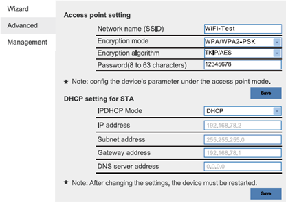

Note: You can modify the Wi-Fi module's SSID or/and password in the 'Advanced' interface.
(SKIP THIS STEP UNLESS IT lS NECESSARY!)
Notice: The AP 'Solar-WiFi' might disappear after inverter connects to WiFi router. Turn off router or do 'WiFi Reload' operation via button on inverter if you need connect to Solar-WiFi once again.
